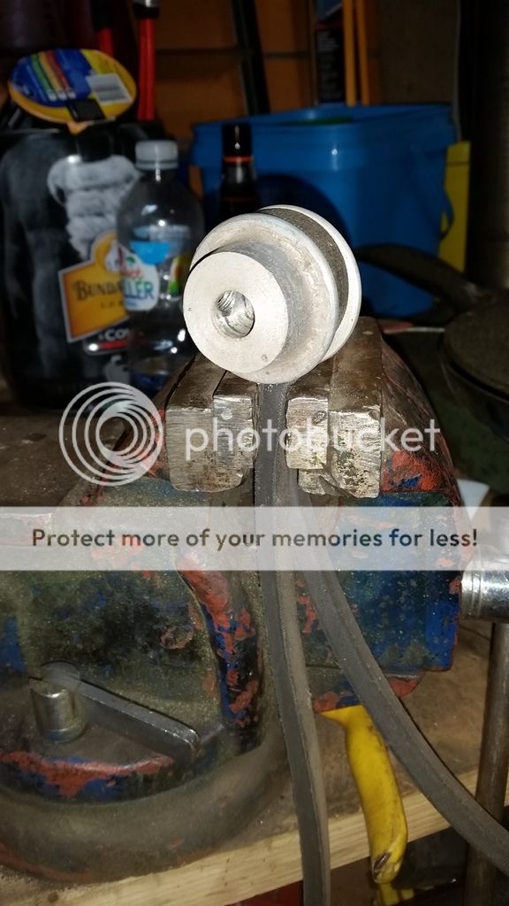

Are you having trouble removing the nut or the pulley?

I used an old fan belt wrapped round the pulley and clamped tight in a vice, then used a rattle gun to buz the nut off
http://i661.photobucket.com/albums/uu33 ... xsdck9.jpg

If you're keen pull the generator apart and hold the armature in a vice (soft jaws?) then undo the nut the usual way.. Or else use your imagination or any of the above suggested methods.......... :wink:

Buy a rattle gun...

I ended up doing just that goodie, got him to test 2 old generators for me too, and they were both not working - so 3 out of 3 buggered!
Got the new pully wheel on, just put it all back, with new regulator and fuse box and all is as it should be, no light, horn works a treat too.
