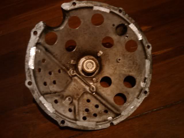

Instead of leaving the 7 o'clock bolt out you can mod the cover, but probably unnecessary unless you're planning on racing like me
I've heard of flywheels and clutches exploding (hence the shields on some race cars) but the scatter pattern resulting when that clutch let go is amazing, especially the chunk that took off the starter extension housing. :shock:

The starter extension is unnecessary as I'm running a gear reduction type starter.
I have once had a clutch go bang on a mini. There were no holes in the wok before it went, but there certainly were afterwards.
