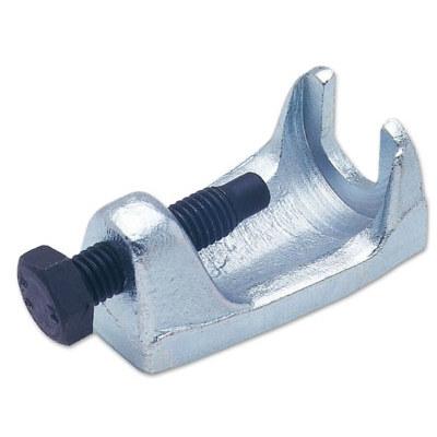

This style is crap. They slip off easily as the fork end doesn't go on all the way.

gotogreen,
That is exactly the device I tried and couldn't see how it could possibly work. Took to it with an angle grinder (several times) and clamped it in place with a G clamp. Worked!
The device I used to have was chamfered (wedged) and worked fine..

I bought one as i had a balljoint that would pop with my forks or hammers. I got it to work eventually and said to myself that it would go in the bin. I still have it and i am still swearing at it everytime it comes out of the tool box.
