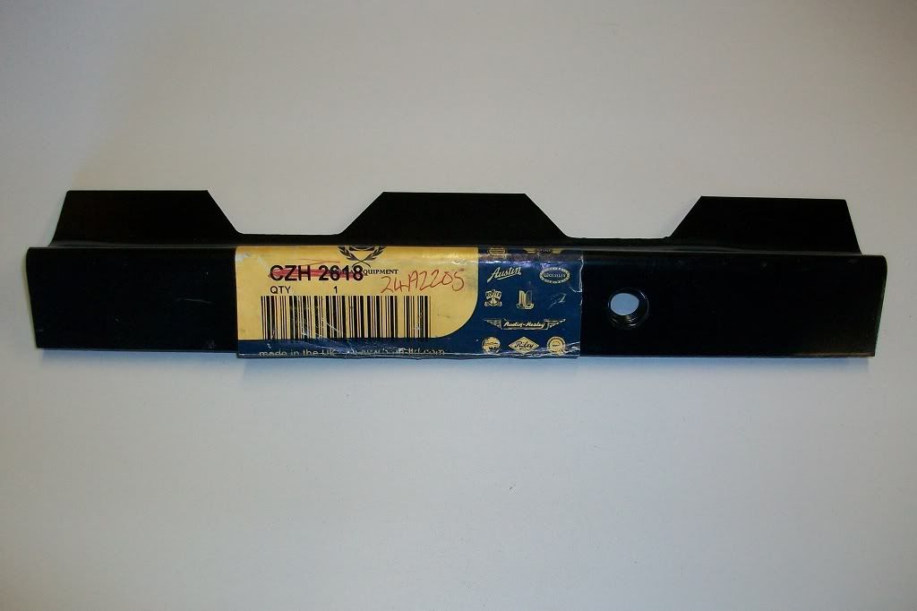

Hi Folks, I found these on the Somerford mini website and wonder if they are the same as used on the clubmans and if they are ADR approved?
They are the lower centre mount.

I will try again.. The Clubmans have a similar bracket. This is a Rover Mini part so if the part number is the same I can potentially use it here. If it is the same part # and was used here it met the ADR requirements for the clubman.
I found part number is CZH2618 and is a British Motor Heritage part: http://www.bmh-ltd.com/miniparts.htm#

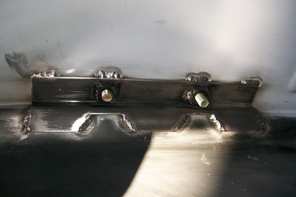

According to the Oz parts books the bracket used at the base of the Mini rear seat brace is part HYA7983. This change was introduced into production on 4/2/71 and continued on to the Clubman body shell. If you want to make one the specification is below.
A reinforced rear parcel shelf to cater for the upper seat belt mounts was also introduced around the same time.
I'm not aware that Rover part you mention was used here. In any case I don't think simply installing it in your car yourself would make you "ADR compliant". It looks to be a beefy part so no doubt would do the job of terminating the belts as well as the factory part.

I want to help the seat belt fitted I use to fit 3 point belts and a baby seat harness point. Then will get engineered. That pick and part number are great. Will see if John Schmidt has it.

I've been through this process with my mini when I got the engine conversion engineered, basically we just replicated the clubby mounts, the upper Moines we reinforced from the front to the back because the parcel shelf had been previously cut out and replaced so this got us to the seat back and the rear window. I'd talk to your chosen engineer before you do anything though, present them with the options you've researched bit too sign it off they are the ones that need to be happy.

There really isn't enough strength in the early parcel shelf for the upper mounts even with the 'legal' 75x50mm plate, though I know of some cars on here that have been signed off by engineers like this... The plate isn't going to help much if what it's attached to can't take the load. My plan was to make a reinforcing plate that tied in to the edge of the boot opening and the seat back.
That's what we did, I probably wasn't very clear though :oops:
